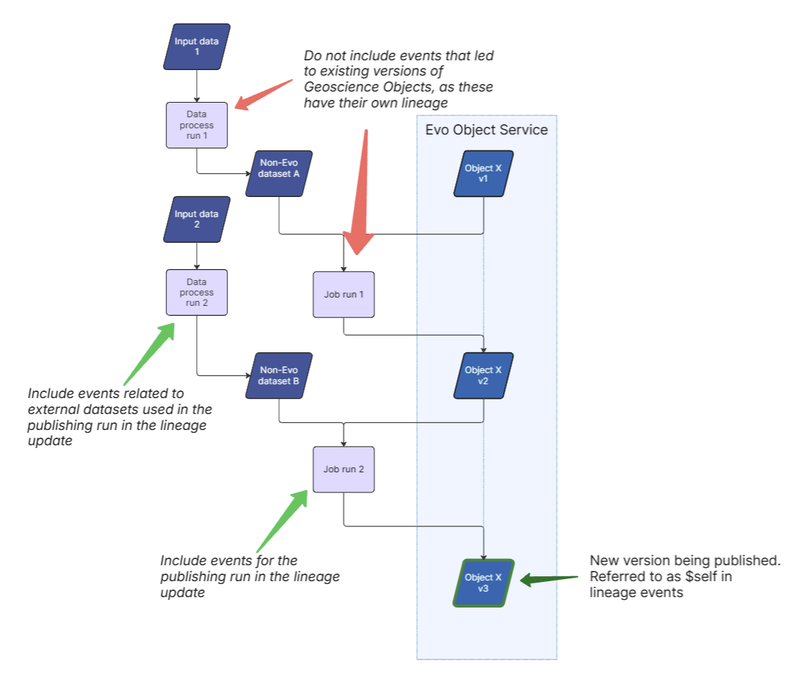

Which events to include?
For a given version publish, the lineage should include all events available for the run that produced this version. Preceding events for runs that produced intermediate datasets that are outside Evo may also be included.
Where the input is an existing geoscience object, events related to the creation of the input should not be included, as lineage should be recorded on the input object version. This includes when a previous version of the object being updated is used as an input, as the previous version should have its own lineage.
Diagram showing events and datasets
Above: an example scenario where the new version being published is derived from an external dataset and a previous object version. The events to be included are those for the run that is doing the publishing, and the one that created the external dataset being used.
