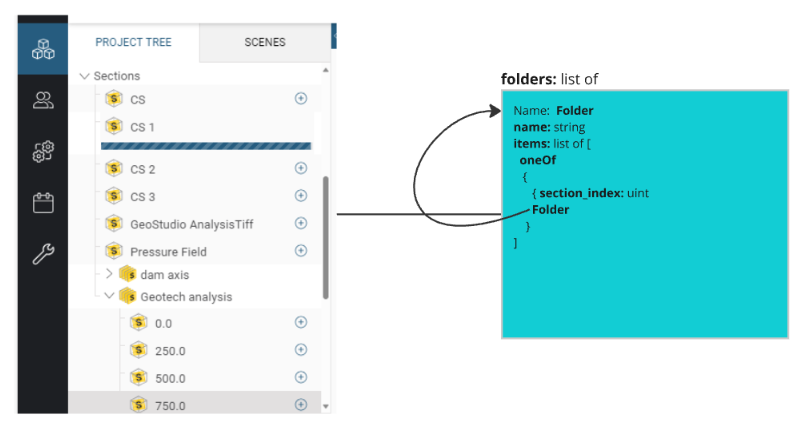

folders array
A recursive list of folders containing indices into the sections list. The folders give organizational structure to the set of cross sections stored in this object.
E.g.
folders

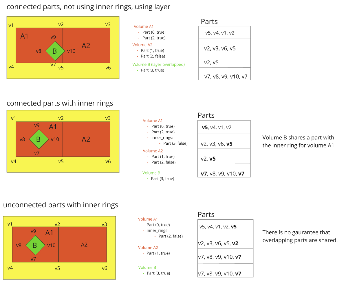

volumes array
A list of polygon volumes. Each volume consists of one or more connected polyline parts which together represent a closed polygon (a ring). Holes in a volume can optionally be represented using a set of internal rings, where each ring is a non-intersected hole in the volume. Holes can also be represented using an overlapping volume in a different layer.
  • name : Volume name
  • description : Optional additional description.
  • parts : Array of polyline parts. The entire array of parts creates a closed polygon. Each entry is a pair of values - an index to a line_geometry chunk which represents a sequence of line segments, and a reversed flag. The same chunk can be used for directed traversal by different volumes, surfaces, or both.

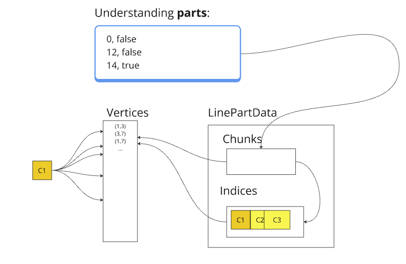

line_geometry
Container of chunks of vertices. Each volume/surface part references a chunk of vertices to represent a collection of connected line segments. A given part may or may not be shared between adjacent volumes and surfaces. Storing a connected geometry using shared parts is preferred but not guaranteed as it depends on information available to the producer when the object is created. When unconnected, line segments in one part may overlap line segments in another part.
  • vertices Table of u,v (local x,y) coordinates on the section.
  • indices Optional table of indices to vertices. This table exists to support parts that contain a non-contiguous collection of vertices. If this table is empty chunks point directly to the vertices table.
  • chunks Part chunks. Each entry in this table is an offset/count pair that represents a sequence of vertices in a part. Two storage schemes are supported:
If indices are missing (contiguous case):
  • Each chunk is an offset/count directly into the vertices table.
If indices are defined
  • Each chunk is an offset/count into the indices table which in turn points to vertices.
parts

Various Representations using Parts
Volumes A1, A2 with overlapping volume B. All of the following representations are valid:
parts
